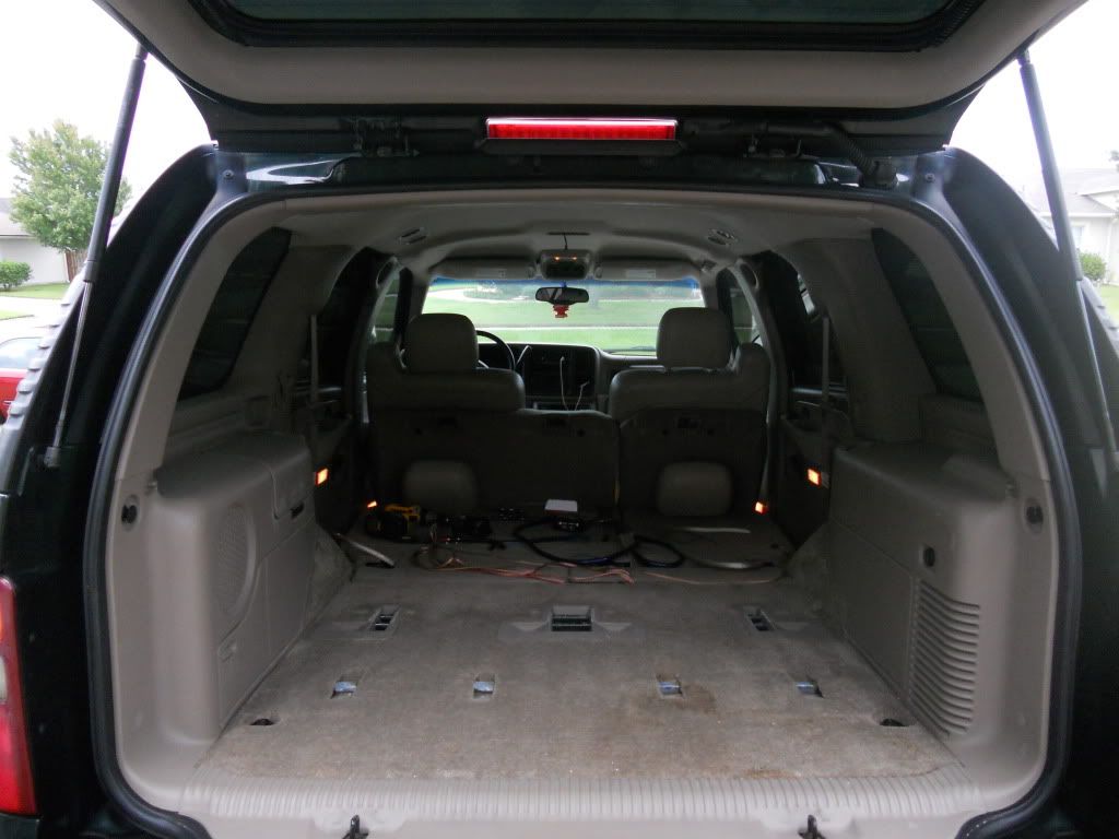

Well I will start with the first DC build that went in my truck. Consisted of 2 DC LVL 5 18's . 2 Crescendo BC2000D's . Mechman 270 alt . 2 XS power 6500's and 1 3400. Goal for the 1st build was pretty much just to crush lows honestly , and it did a great job at doing so. Broke a good majority of stuff in my interior lol. On with some pics of the 1st build ( 2nd build is ongoing right now )
Out with the 4 12's Wiring was all done on a previous build.

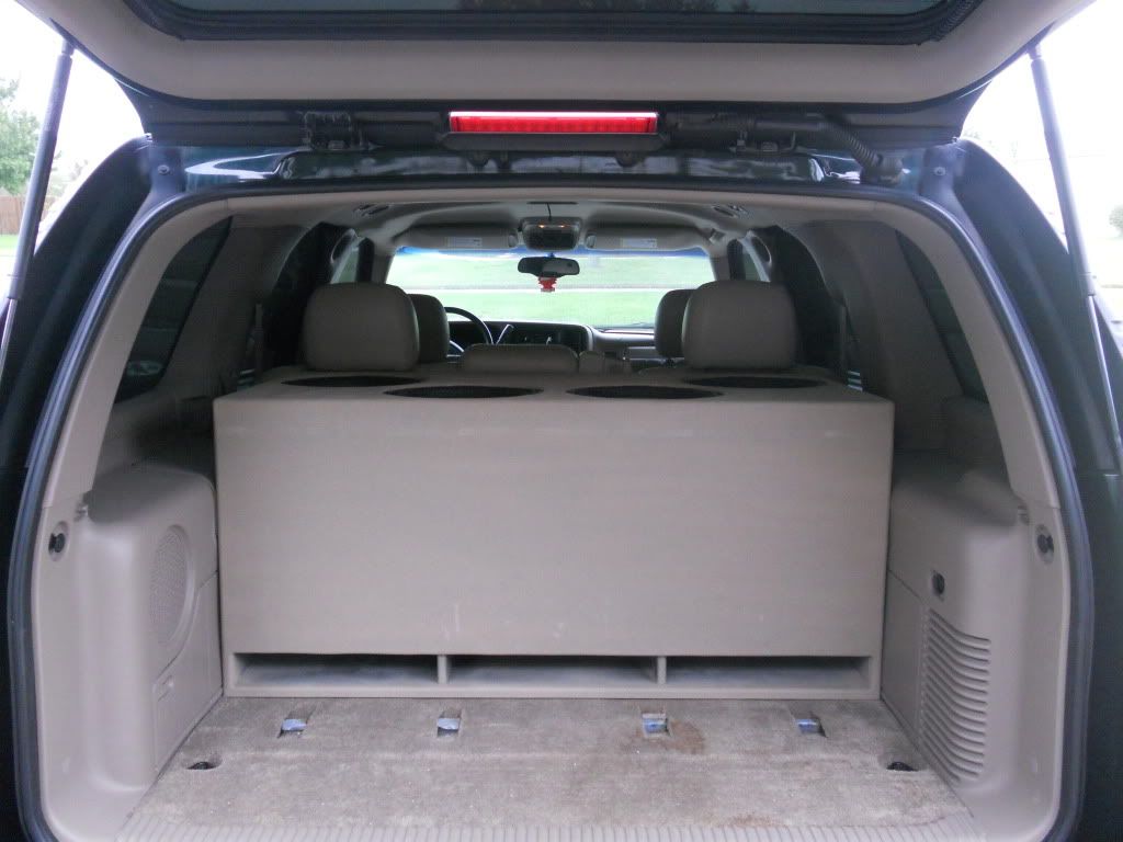

Box is 16 cf tuned to 29hz.

185 sq inches of port.
