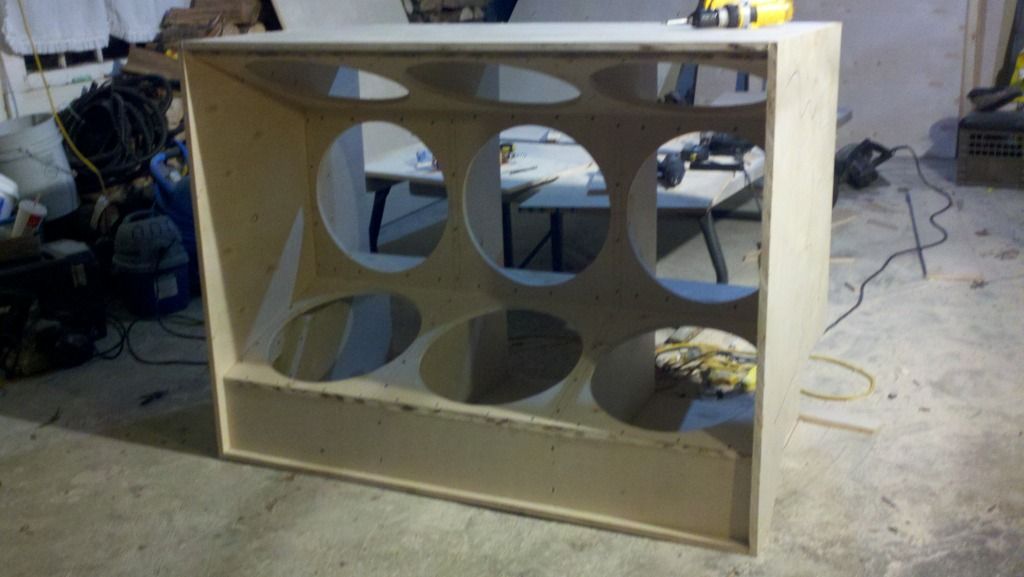

The beginnings of the box. All of it was made with 3/4" birch plywood from Carter Lumber, only $34.99 a sheet there!

The baffles installed...
Dividers/braces inside...

The sealed portion of the box is 6 cubic feet per 3-18w6, so 18 cubes total....stuffed with polyfill too once it was in.

The box put in the van, ported chamber starting to be built in front of it. The ported chamber is 54 cubic feet, so box is a 3:1 ratio 4th order...
