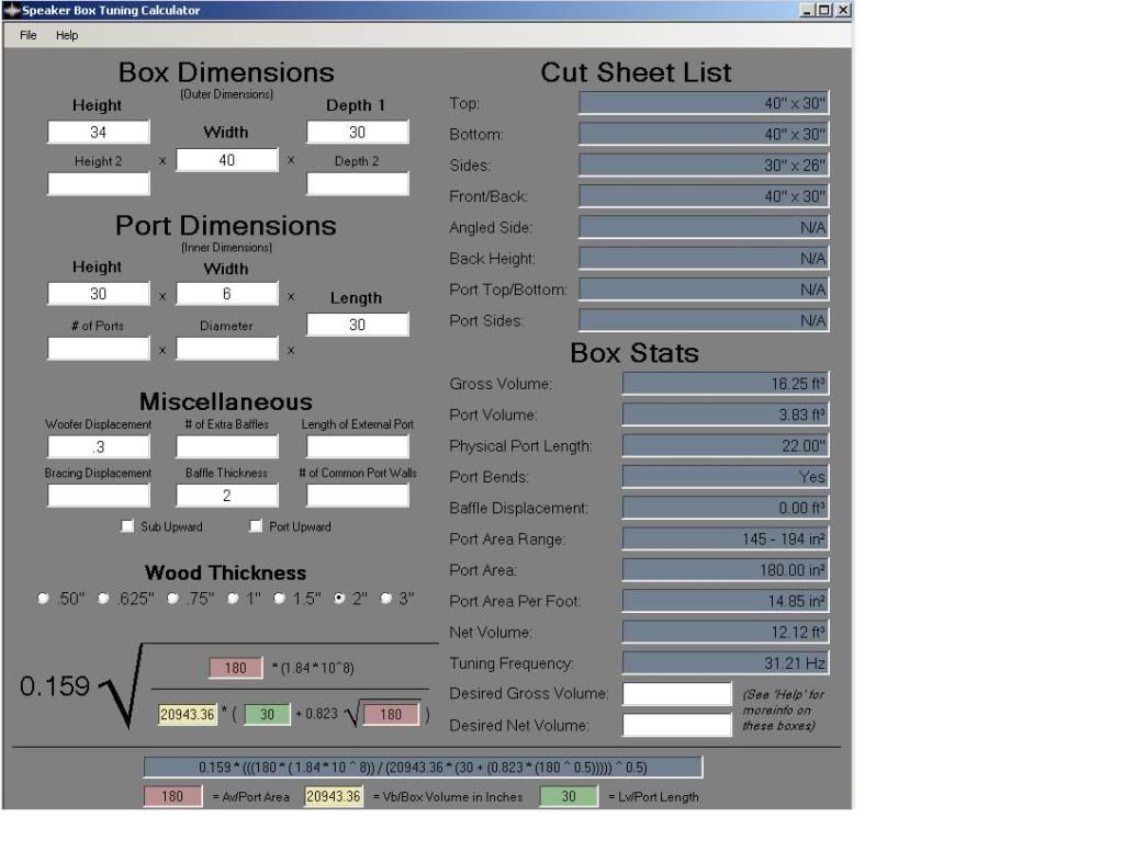

just starting a log....austin says he wants me help him do a wall....ill let him post up the details of the jeep but theres gonna be 3 sa 15s in a flat wall for my idea then hes gonna try to get a 4th order design mayb....(i dont wanna do it) LOL......so heres the 1st draft of the wall/box w a big ole SLOT PORT

heres wall # 2 w AERO PORTS........power on these is suppose to be 3k but we will see....once he decides on amp i will make smaller changes to designs to acomodate(SP)

41 2x4s for the shell and one sheet or birch for the baffle!!!!!!!......150$ wall FTW well thats the cost of the wood....add sum glue and sum resin and glass mat and screws.....i bet we can do it for under 250$ in materials

2.5" thick shell FTW!!!
You neglected to put "3" in the common port walls section. That will change the volume and tuning to 11.36net and 31.12hz.
I believe we decided to go with the areo port wall. Nothing against slot ports but I like the sound of a areo port better.
It's going to flex all over the place.
How do you know that. I don't know im not good at designing an building enclosures yet but just asking.
thats exactly how I built my wall, except with 2x8s and shit feels solid.
