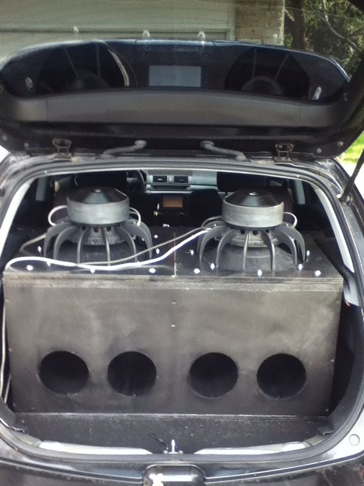

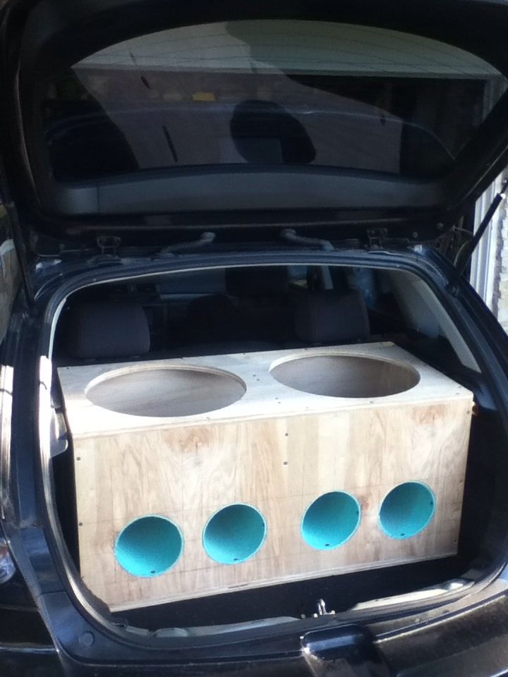

5.8cf net

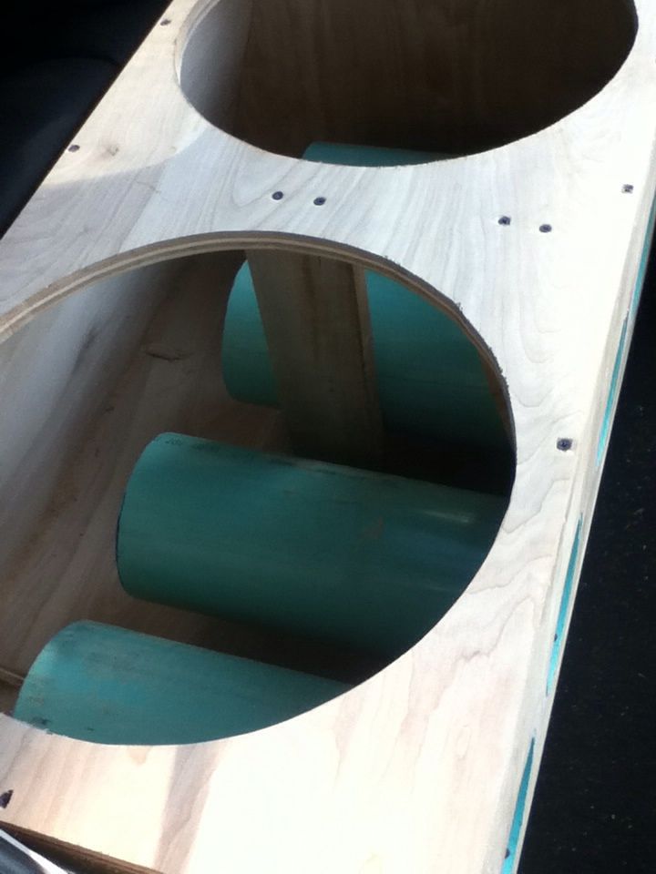

4 6" PVC tuned to 48hz (ima plug 1 or 2 for daily if I need to)
Oooohhhhh that's wtf it's for
Looks nice I think

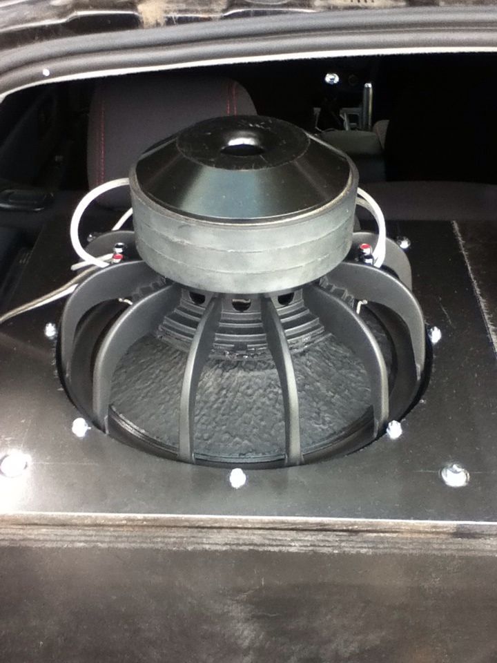

2 sundown Zv1 15's (1 has ns coil and Zv2 cone and spiders) just didnt recone the other yet, but its working as is.
5.8cf tuned to 48hz with 1lb of polly fill
4 6" pvc 15" long
2 spv70's

Sorry for the delays went outa town for work but got to drive for a solid 4 hours today and never hit thermal protect with my poor electrical and the amp stuffed under the box
But the subs do get rather hot even the motors were hot but they are still holding up and sound awesome
