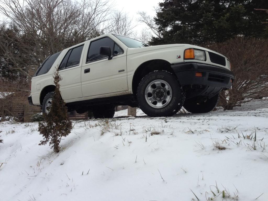

So, on to the good stuff..This is my Frankinbeast - I call it "WhiteNoise"
It is composed of all the audio stuff I collected whilst being broke as a joke....
All work is done by me at home, exhaust was only thing, I borrowed my buddies shop so I could use the lift and not weld laying on my back.
White 92-91 Rodeo, 3.1 v6 4x4, 5 speed.
-New clutch 6mnths, new front driveshafts and hub inners 3mnths, New rear end inners 2mnths, New air shocks for Wall build 1mnth...
-New windshield 3mnths, same crappy tan interior that came in it....FML is not Priceless
-Custom exhaust - more because my old exhaust was falling off
-I have painted all the exterior trim and underbody black
-Tinted windows
-Got 2 sets wheels and tires - one chrome/mud and the other black/street
-Installed Viper alarm and door locks
-Air shocks in the back running 50lbs psi, max is 120lbs psi - good for 1900lbs
-LED dome lights - white, had HIDs but ballast blew, so hyper white bulbs for now. Gonna do a 2004 Rodeo front end swap so I can have clear headlight housings and get HIDs back again. A number of Dent repair and re weld the driverside back door seal. It had rusted out.
-Shaved the antenna off the front fender are relocated behind fender, antennas are in my OP
