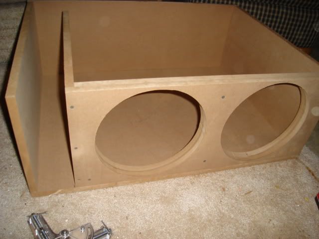

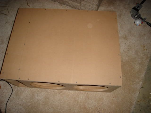

This box is for a local friend and his two Konaki 1207A's (DD9512 clones).
Specs:
4.1 cubic feet
33Hz tuning frequency
48 sq. in of port area
H: 13 1/2"
W: 34"
D: 25" deep (should be fun getting it into the trunk)

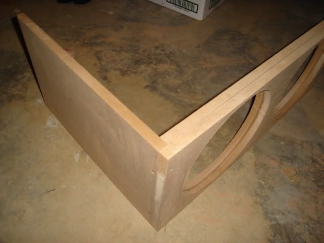

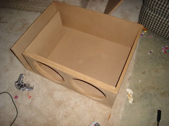

Double front baffle

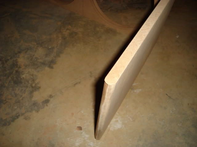

Rounded Port End
Nice and flush
Sides up with baffle installed

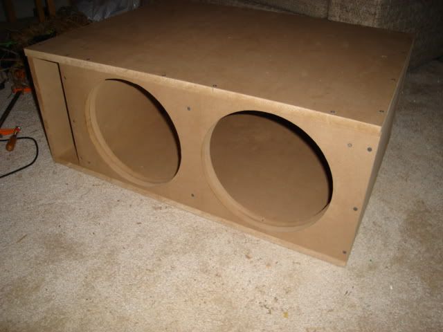

Box all finished...
or is it?!?!?!?!
The box was cut, put together, and then only screwed together in raw wood form so we could test fit it in his car. Didn't want to get stuck with a completely assembled (and carpeted) box that didn't fit lol.
