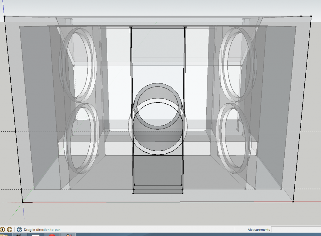

minimal words maximum pics
(1) 5500 for now, when i get 2 more 12s for a total of 6 i will eventually add another 5500 as well
4 old version "1500" rms dp beasts
gutted shell from old 2 sp4 18s
(1) 9" custom aero port
the design
the progress
should finish the cuts tomorrow for the full dry fit
SUBS: 6 ia dp 12s
SUB AMP: 1 IA 40.1
HIGHS: 8 apmb 6s and 4 tw44 tweets
HIGHS AMP: nendo 1kc4
BATTS: up in the air
ALT: 320a Tenney alt

Rear port firing directly into front port? Sounds like no back pressure, ripped surrounds, and bad sound is in the future of this build. Who designed that box? Hope you didmt pay for it.

Yeah, just use l ports for the inner box and have them fire perpendicular to the front port along the back wall
i did the design and multiple others, with the help of a buddy who has done multiple successful 6ths like this.
at first i questioned it, but he said give it a try and see what it does in this particular application.....
if it fails, i have plans to take the 2x4s out and change to a top slot so the rear port has a nice solid load

plus in the design it looks like its ass to ass with the front port but theres about 6-7" from the front
