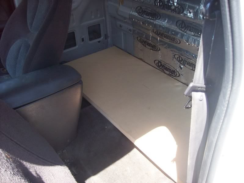

The box is going in the extra cab, a big slant front 12.92cuft before displacement tuned @ 33.5hz Two Alpha Max 18's on One D9 (@.5ohm) and 4 Kinetik HC2400's and Mechman 250amp alt , Eclipse CD5030 , two layers of Dynamat Xtreme on the roof one layer on back wall, : First pix more tonite

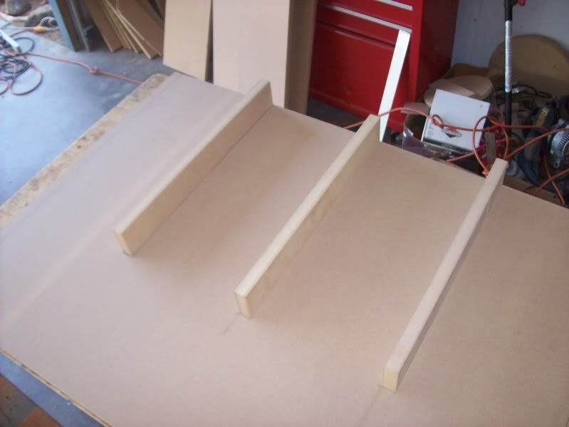

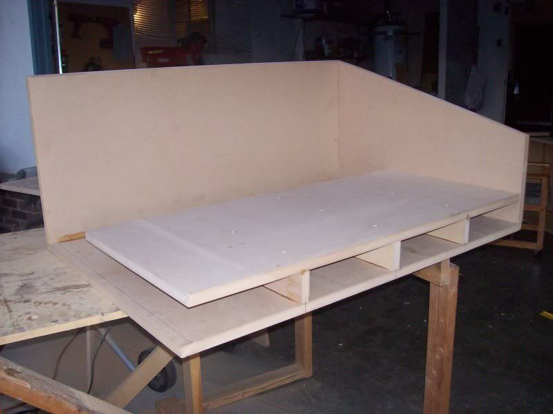

Rear box wall 49"Wx34"H with port runners , port is full width divided into 11"Wx3"D runners (4 ports)
Box Floor 22"Dx49"W 12.53 degree front edge angle
Port finished
Box Floor
Side up / dry fit
both sides attached :
