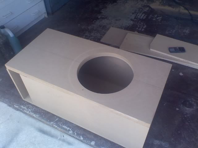

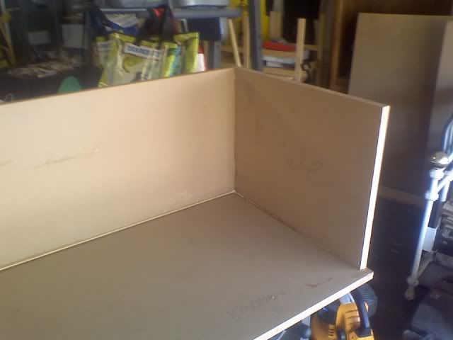

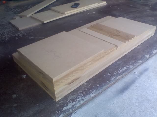

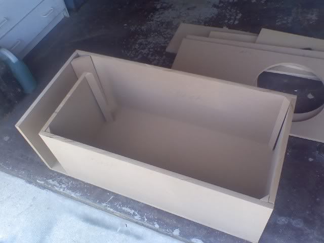

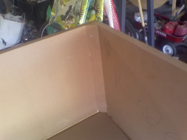

Alright another enclosure build here folks....
box is 4.3 ft^3 @ 35hz for a 15" btl... biggest i could get a box for dudes wagon.... black port grey carpet 45's in all corners
on to pic of design
pics soon to come... and are here!
mock up
with baffles on
right side
right side 45
left port side with 45

NEW PICS! BOX IS DONE! total build tim... 4 hours 43 minutes
talked to customer and he wanted a rounded over port edge so he got it
lost pic of double baffle but here is just first baffle
and all carpeted up
