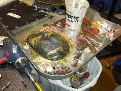

Ok so this is something i started around the middle of 2013, but I plan on making some changes pretty soon so I wanted to post what I already had going on so for....
I'v been having the Infinity Ref-6500 comp. set for a few months with the 6.5" mounted behind the door panel which is probably killing a lot of sound. I started this without to much idea of how I was going to do what I had in mine which was have the door speakers pointing more towards me like the speakings in the kickpanels are, My main goal was sound, the second was looks, the problem was the arm powered (aka manual) window cranks. They had to clear the design that I know would hit me at any time....
In the mean time I took few mesurements to see what I had to work with then took the door panels off and started cleaning them up to see what I had to work with behind them
By this time i decided to ditch the window cranks and ordered some power window regulators and motors off ebay so I needed a design that would cover the holes so i didnt have to buy a new door panel. Also being that its a older car i cut the factor grill out of the door panel to have more air space on the pods....
Here's the temp design for the power window switches I used until I got some from the junk yard....
I had hell trying to it right with the way i wanted the speakers, I wanted them to go inward on one side the out on the other if that makes since to anyone...
Here is is after laying down the faberic and first coat of resin...
and milkshake...
sand sand sand...
Paint, rubberised undercoat....
Test fit
bolt and fiberglass to door
Done deal...
