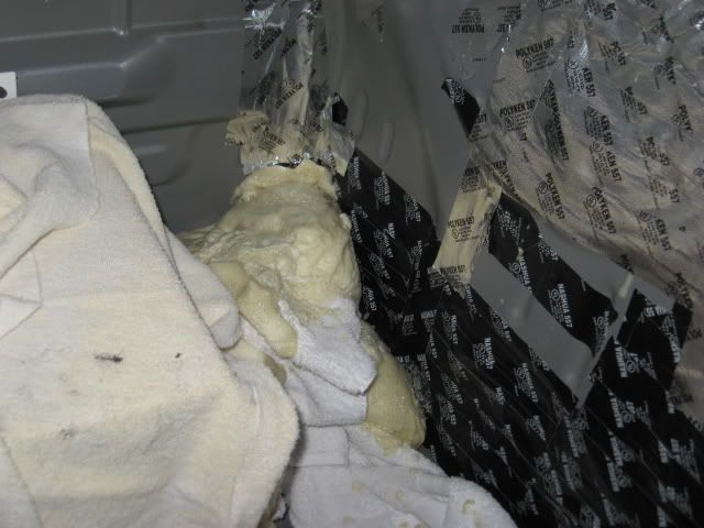

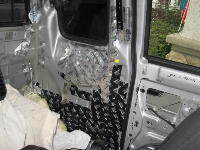

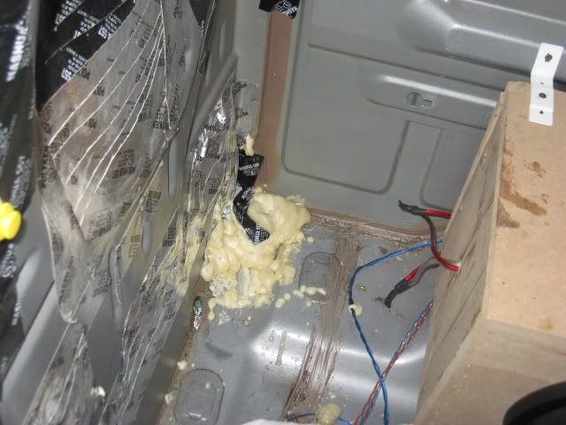

this is my start of a big build i kind of jump around a bit so sorry if its confusing i started with taping up some holes in the extened cab part for some expanding foam
i had a couple of leaks lol
this one is pretty bad the towel was my effort to stop the leak it didnt work at all i then had to pry the towel out of the foam
i turned out pretty good once it dried and i cleaned most of it up it sure made the panel a hella of alot more solid
