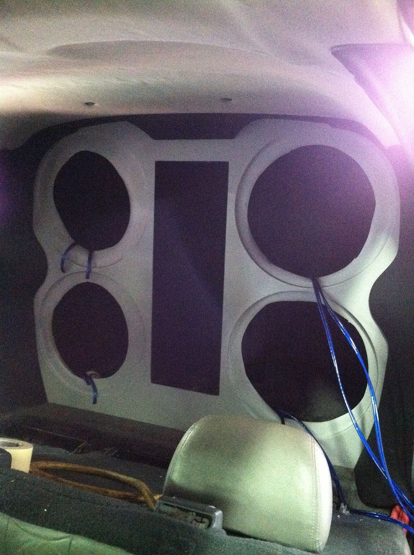

I just got the truck back and will be installing the batts and amps tomorrow and get it playing.the box is triple layer front baffle and then double walled and has metal pipping front to back and side to side. The port braces the top and bottom. Roughly 29^3 tuned to 30hz with 300" of port.

I saw the last picture posted on facebook earlier. Looks killer. What's the bump out for between the subs on the outside?
Not sure what u mean? U talking about the fiber glassed side panels that flow beautifully onto the wall? Lol

Oh I see it now. I thought the baffle itself was cut like that but now I see it's just the c-pillar plastic that is shaped that way and goes in front of the baffle
