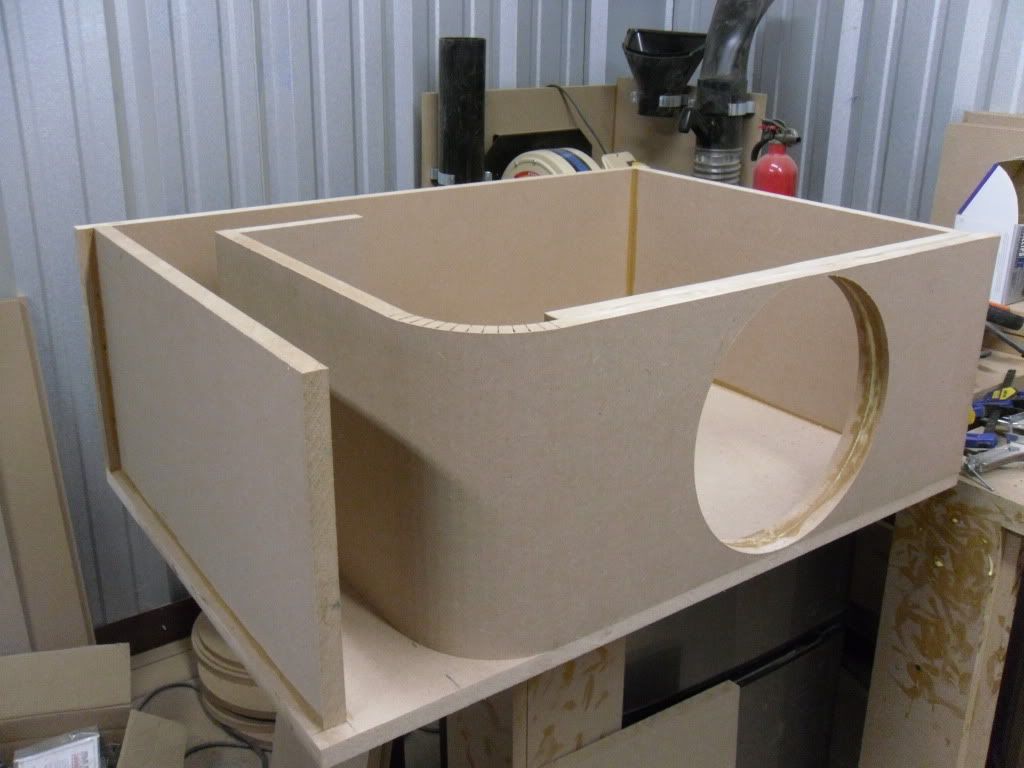

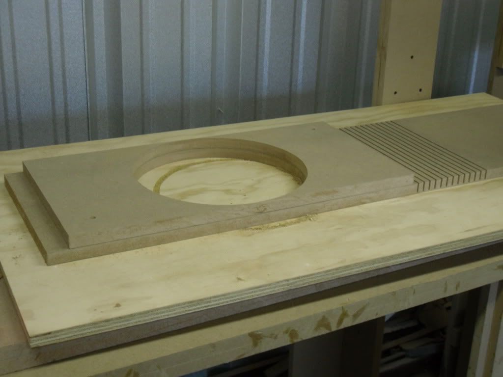

Alright, last night I didnt get out to work on this but got a nice chunk done today.
Got the kerf done..
Inside layer going on and holes cut..
Mock-up..
45's cut..
Mounted..
45's on the left in (I made a slight change to the design for the front 45 but wont effect anything)
Other side's 45's in...

Everything in minus the small piece that goes on the outside of the port..
Got that piece in for this pic..
More as it happens..
