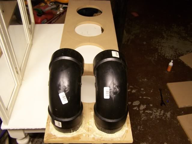

after all displacement its about 2.8ft^3 @ a nasty 26hz-35hz.... easily change tuning
I call it the BONER BOX! lol

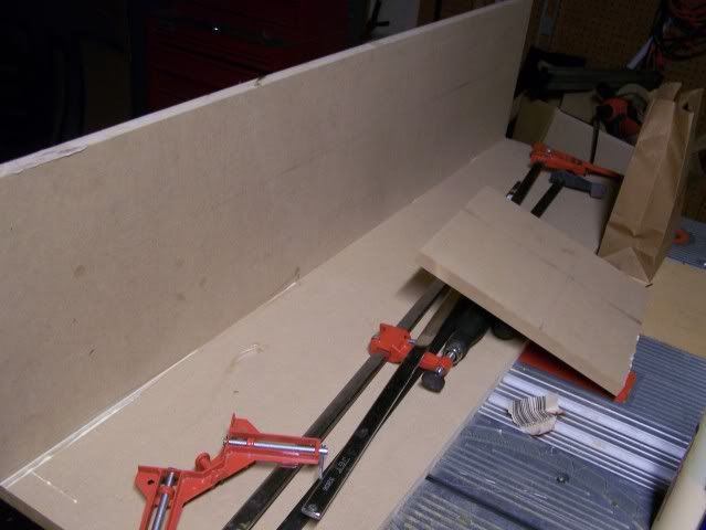

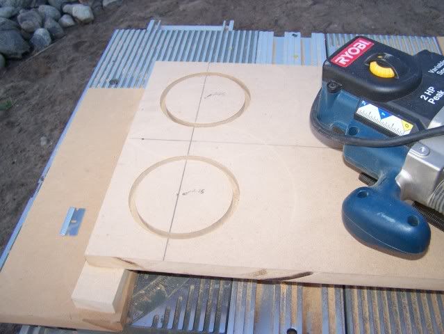

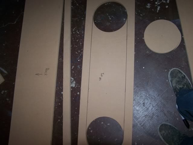

only have a few pics but all pieces are cut baffle cutout done except for top. Port is glue n right now as I type!

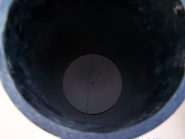

port cutouts
Fits like a glove!

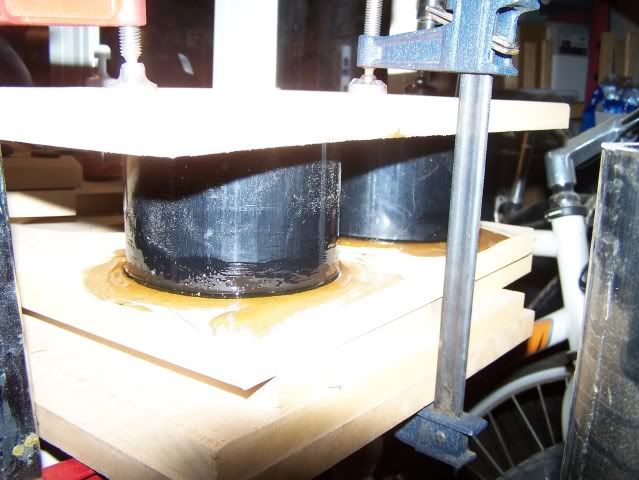

gluing the 4" risers/small pieces for port in order to connect the 90's and have the correct amount of depth
gorilla glue FTW!
This right here will have the box around 3ft^3 @ 35hz.... i can add pre-cut pieces to the elbows through the cutouts and drop the tunning all the way down to 26hz!
Front baffle still needs to be cutout and flush trimmed. will do tom.
back is on

Nicely done but maybe rounding over the pvc ends in the interior with some sandpaper or the dremel would be best, but shouldnt matter too much.
i did that actually
heated the ends up with a torch and smashed into a bowl to get a little flair
