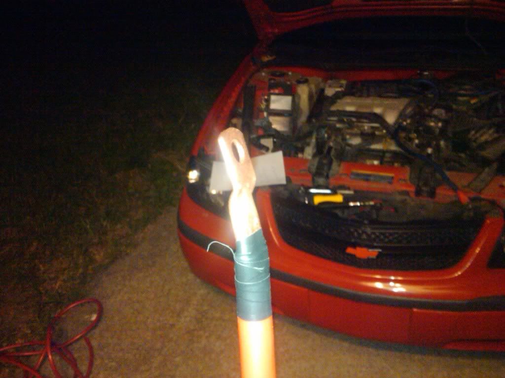

lookn good man only thing i have to say is re route the wiring so not so close to manifold heat and wire don't mix. tie it back with zipties or something.

i have some cable covers over them. would that work?

the way routing of wiring is look's like from pic also very close to serpentine belt try to re-route if hit bump or something and wire bounces wrap around belt pulleys oh i dont wanna even imagine that horror.
x2.... try securing them somewhere with zip ties or something. thats what i had to do with my 4 runs of 0gauge.
