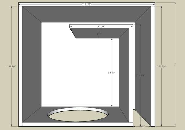

I was wondering if this box would be ok for 1-15"' DC XL. If anyone has any boxes they used for there single 15 that is less then 32" wide.
Net volume: 3.5cuft
Tuning: 33Hz
Port Area: 52.5(15"Hx3.5"W)
Dimensions:16.5H"X24D"x26.5W"
Or
Net volume: 3.5cuft
Tuning: 35Hz

What amp are you going to run to the XL? If you plan on running over 1500w, I would shrink the box down to about 3ft net.

Port area is a bit lacking.

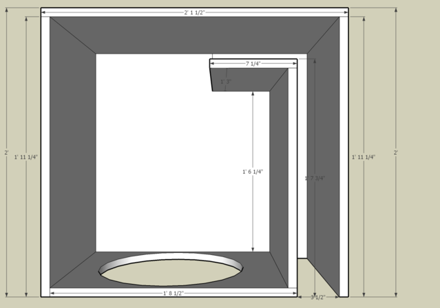

What about this one?
Chrysler 300 on 24" Menzari's
Alpine 9887 Sundown SAZ-1500 3-10" SAs Walled off
Do you have any box designs that would be better? This is my weakest are when it comes to stereos

With running a Sundown 1500 to the XL 15, I would stick with the 3.5ft3 net but make your port area around 60in2.
