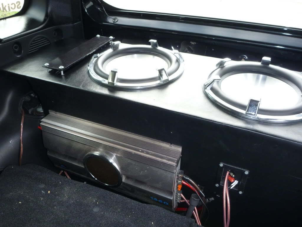

my problem is, I have no place for an amp. it's currently mounted on the back of the box, behind the rear seats (2006 scion xb). basically the amp is overheating due to lack of air flow/space...

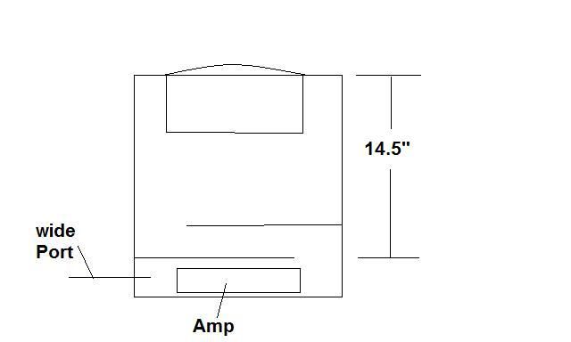

my thoughts for the new box:
^^(side view) the "amp area" would be added on, keeping the same interior box dimensions and lifting the box a bit higher....
actually pics of the box:

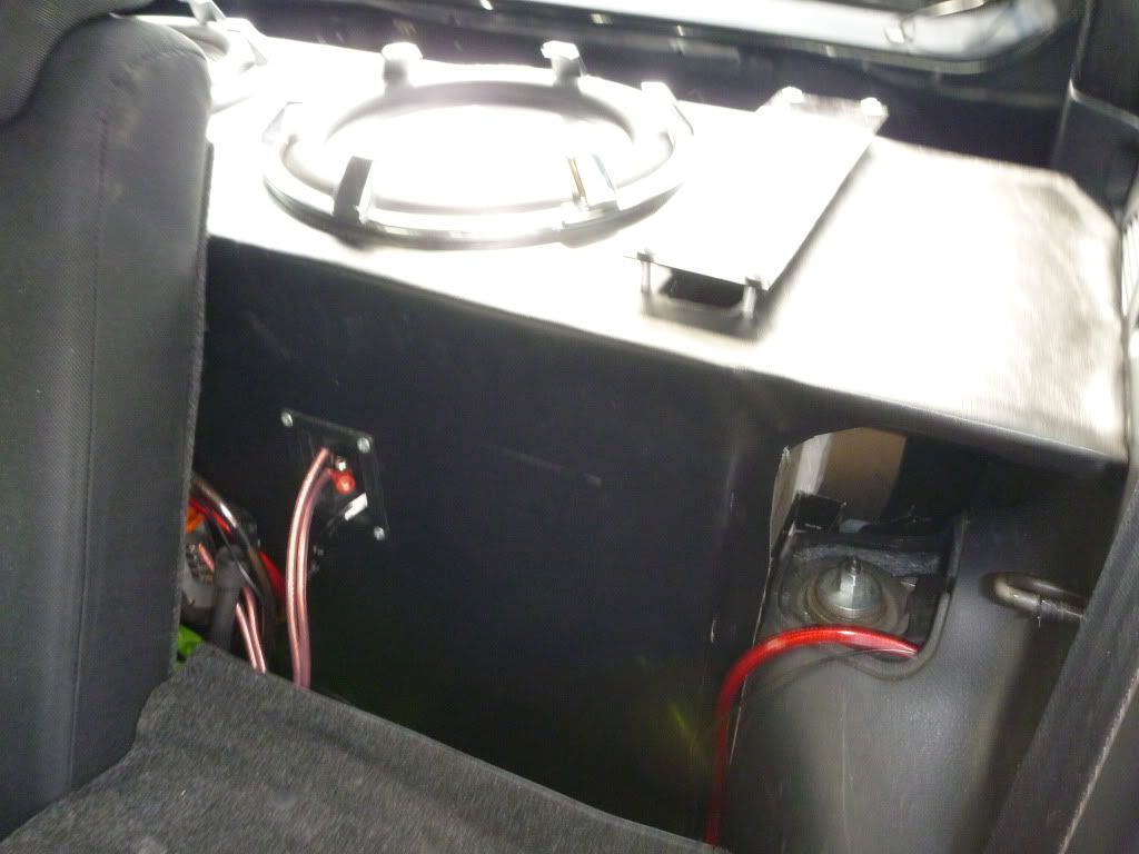

^^ as you can see, very little amp space. seats pretty much (when up) sit on the amp...
^^ugly wiring, but you cant see it....
the possibilitys of the new box is to either have the new "port" faceing the back side of the seats, or to face it towards the trunk w/ vent so the amp is not visible....(its an ugly amp)
I prolly could really simplify this by just floating the amp over the subs, but I dont like the look of the amp. and I'm into car shows, so its all about appearance.

If your amp is overheating, just turn the gain down. Clipping can easily cause overheating. Plenty of people run their amplifier in a similar spot without overheating problems, so I'll assume it's a tuning issue.
Besides, you can't put an amplifier INSIDE the port of a box. Not only would it restrict airflow and ruin the output, but it would rattle the damn amplifier to pieces, plus the wiring would look atrocious on top of all that.
Let me recap: turn the gain down.
Also, check all your connections. Make sure everything is snug, make sure all your ring terminals are properly crimped or soldered, and make sure your ground is on a well-sanded piece of thick frame metal and not some thin piece of sheet metal with paint on it.

anyway, you can't just modify a box like you originally suggested, you'd have to build a brand new box. The box is not the reason your amplifier is overheating so forget about that for now.
As for having it mounted on the back of the box and rattling... it's not a great spot for that exact reason but lots of people do it anyway, so it's good enough until you do a new setup.

no good. the body is sheet metal. you want it grounded directly to the frame. find a bolt on the frame and ground it there.
also, having no air flow could speed up the process of your amp overheating, but the reason it's generating so much heat is almost certainly because the gain is too high and the amp is struggling to make more power than it's comfortable with.
