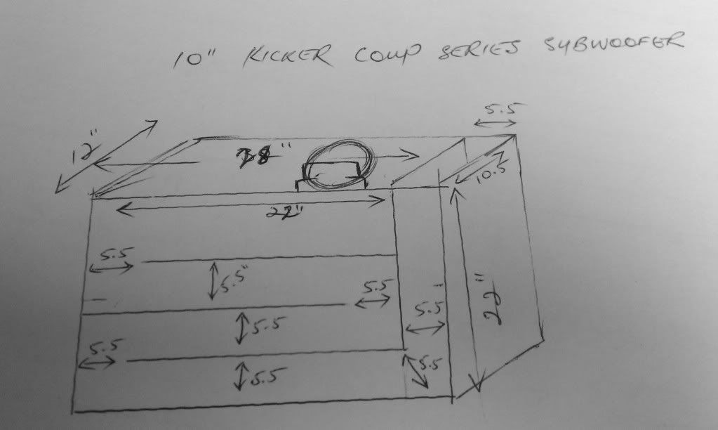

Hey i am very new to this stuff but is willing to learn i have a 10' kicker comp that i am trying to build a tline for ...
this is what i have so far.................
10' Kicker Comp
Specs
Model C10
Size (IN.,CM) 10, 25.0
Impedance (OHMS) 2, 4 or 8
Max Rec amplifier Power (WATTS PEAK/RMS)* 300/150
Sensitivity (dB 1w/1m) 86.2
Frequency Response (Hz) 30-500
Mounting Depth (IN.,CM) 5-1/16, 12.8
Mounting Cutout (IN.,CM) 9-1/8, 23.1
Min Rec Sealed Box Volume (CU. FT., Liters) 1.0, 28.3
Max Rec Sealed Box Volume (CU. FT., Liters) 2.4, 68
Min Rec Vented Box Volume (CU. Ft., Liters)** 1.25, 35.4
Max Rec Vented Box Volume (CU. Ft., Liters)** 1.75, 49.6
[IMG][/IMG]
