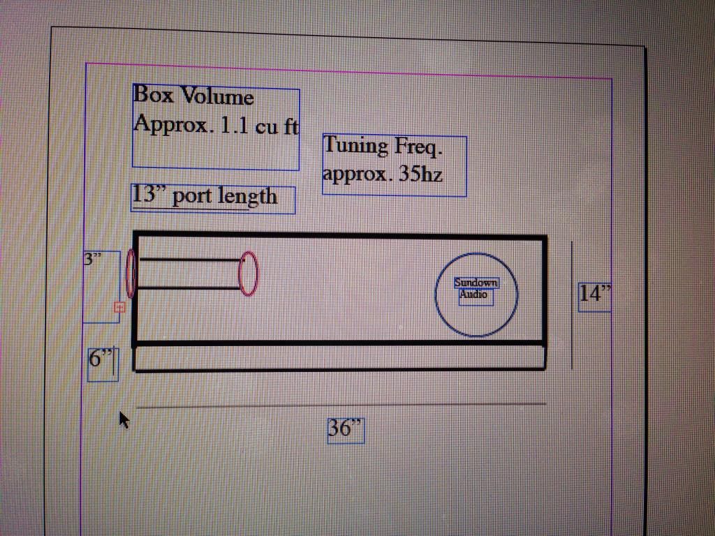

Hey guys, I was wondering if this design would work? I installed a Sundown SD-2 10" running on an alpine mrp-m500 in my buddy's 2012 crew cab silverado. Already went through a prefab and it did not work out due to this sub having a massive surround. I built a .65 sealed box upfiring under the rear seat and it came out to a perfect fit and sounded good but the output is just not enough.
The specs for this box would be 36"x14" with a 6" height with a 3" aero port. I was wondering if this could work considering the box is very thin..? and if it can does upfiring vs downfiring make a huge difference being ported? excuse my noobness im very new at box building but have done research. Thanks in advance
would be like this but longer

Or could I use a slot port coming out the front?
