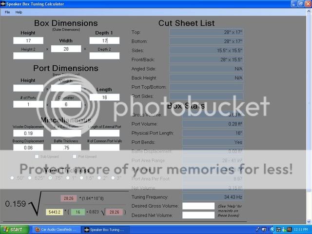

This box is for a 2002 re audio hc 15 dual 2 ohm. Will it work good for that sub? (the port will be flared on both ends and it will be about 18 inches long flared and 16 inches of port)

Is the port going to bend or is it going in the side of the box?

Side of the box.

What's it for bud? Might help a pinch.

Box seems small for a 15", i'm doing some searching now give me a sec.

Well my max dimensions are 29" W x 17" H x 17" D
EDIT: I'm wanting to save as much space as possible and the sub is rated for 1200 but can take 1500 without any problems

Anyhow. As i said, box is small for the 15" (from what i've seen on ROE) Where's it going that it's confined to 17"?
