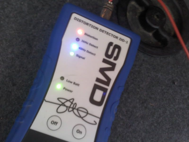

Alpine 7894 (4volt) connected to stock speakers so we could only use volume 23 of 35. I've tested the RCAs clean/distortion free at volume 35 using [email protected]/1000hz. Subsonic at 1/2, LPF all the way up, no bass boost.
We used [email protected] tone to set gains. It was too dark for my cell phone camera to do video, so I just took two pictures.
DD-1 right before testing with DMM
Look at gain position, barely past 1/5 gain
Discuss.

he said it clips more than a barber.

Probably closer to half or more as I'm sure he's getting very low Preout voltage at volume 23 lol. It's be an even better test with a clamp to really see how much clean power you have with that haha probably a couple hundred watts at most.

it doesn't mean much because they did not do a full test and decafs post is too vague.
he/they think that amp distorts with minor input while driving an unspecified load on an unspecified power supply because they used a device designed to determine clipping at 40hz.
[watch as they/he will now spout numbers trying to live up to the requirements I've laid down]
