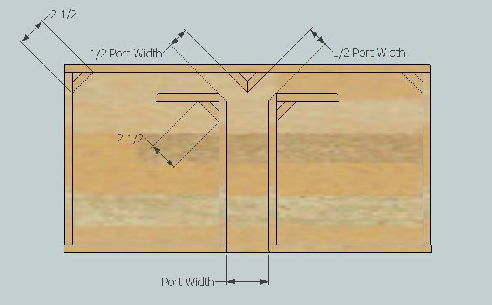

Edit: sidenote: im building a ported box tomorrow seperated chambers. the ports meet to form a large port. how do i calculate the size of the triangle of 45s i need to cut to put in the center of the port to keep them from loading against eachother?
thats essentially what im doing stole that off of google. itll be 2.5" coming in each side on the back and 5" of port width coming out
