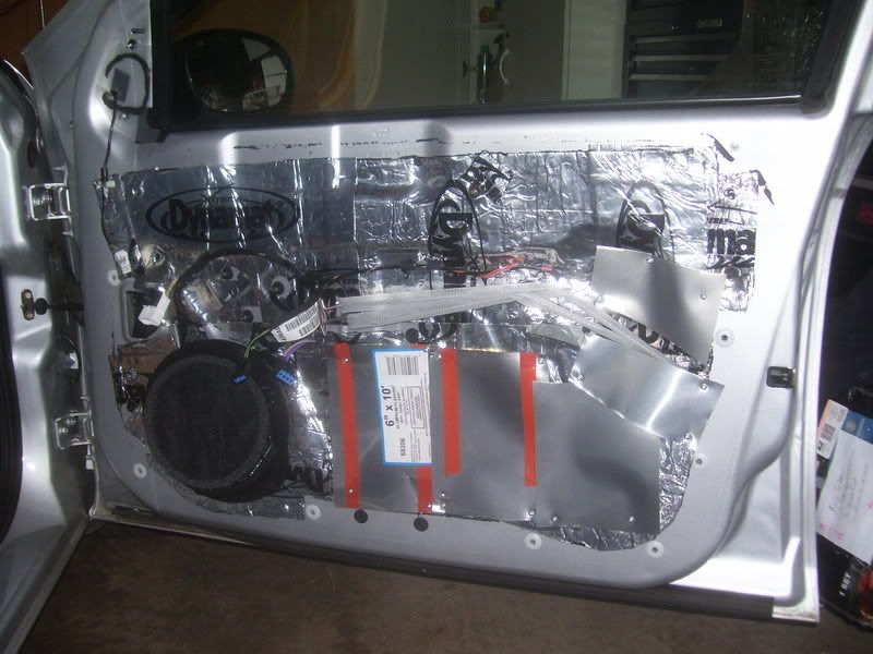

Not my pics, but I did exactly this. It worked great and it isn't permanent.
Deaden outside of door.
Deaden inside of door.
Cover holes with aluminum roof flashing secured by sheet metal screws.
Deaden over that.

That looks nice & thats probably the method i may use to deaden my doors thanks 4 the info & pics
