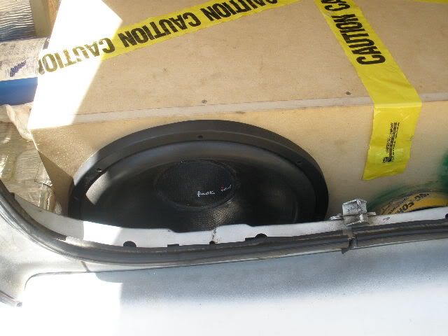

I have a 2000 Crown Vic Police interceptor,
My audio system consists of
CCX 6.5 set
RF punch 301s
18" BTL PSI recone
7.5 cubes at 34hz with 2 8" sono tubes as ports
175 amp alt with diode voltage mod.
Big 3.
Ive also swapped in black leather 6way power seats from a lincoln TC, and Im in the process of painting my interior black.
Heres a link to my YT Gettin low - YouTube

Is that Punch 301 your sub amp?
You have GOT to get those ports away from the rear wall like that. You'd probably be twice as loud with sub up and ports to the side.

Sorry I left out my sub amp is an AQ 2200d.
I didn't design the box, I just built it, I want to either trade the BTL or build a new box soon, Im aware its choked back there.
Did a 145 at 39hz with that set up first time on the meter.

yea those ports r too close to ur tail lights.

I appreciate the offer, but im looking forward to designing and building it myself if I go that route, Ive had this set up for almost a year, and Ive learned tons since I decided on the 18" set up. Id like to do something more cosmetically appealing while still increasing output, and freeing up some trunk space.
This current box sounds fantastic on music though thats why Ive been procrastinating on remodeling along with $$$$ issues.
