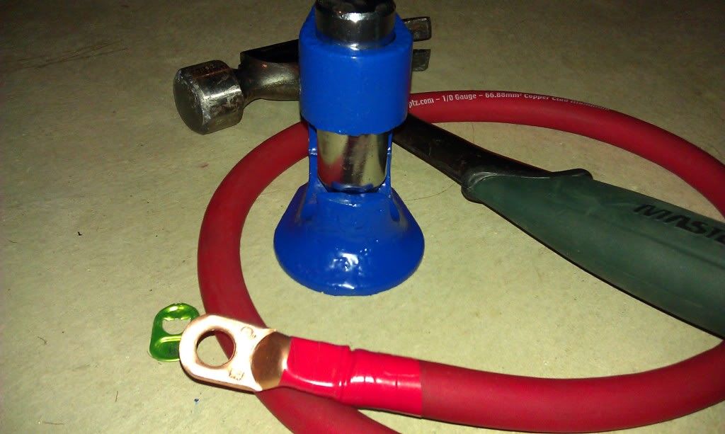

Crimped my own 0 gauge power and ground wires using copper lugs.

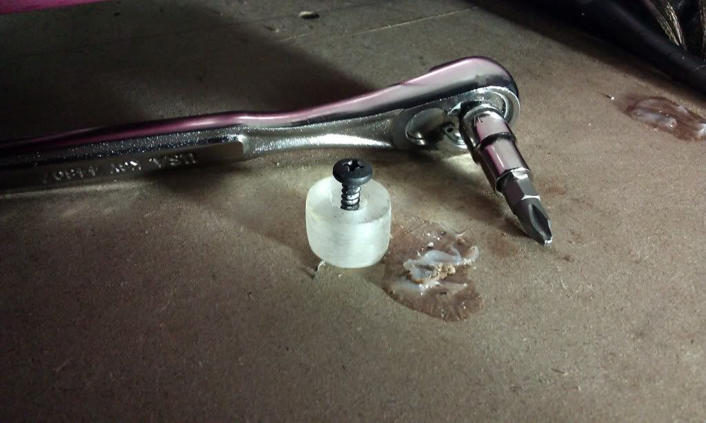

Because of the height in my trunk on top of my box I had to use a ratchet for a screw driver

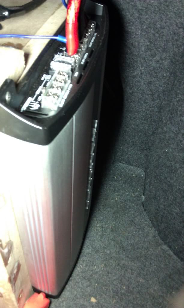

The amp is wired up and cable managed.

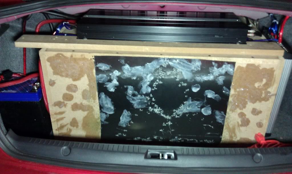

I used 100% silicon to fill any brad nail holes in the box, and screw holes from previous amp.

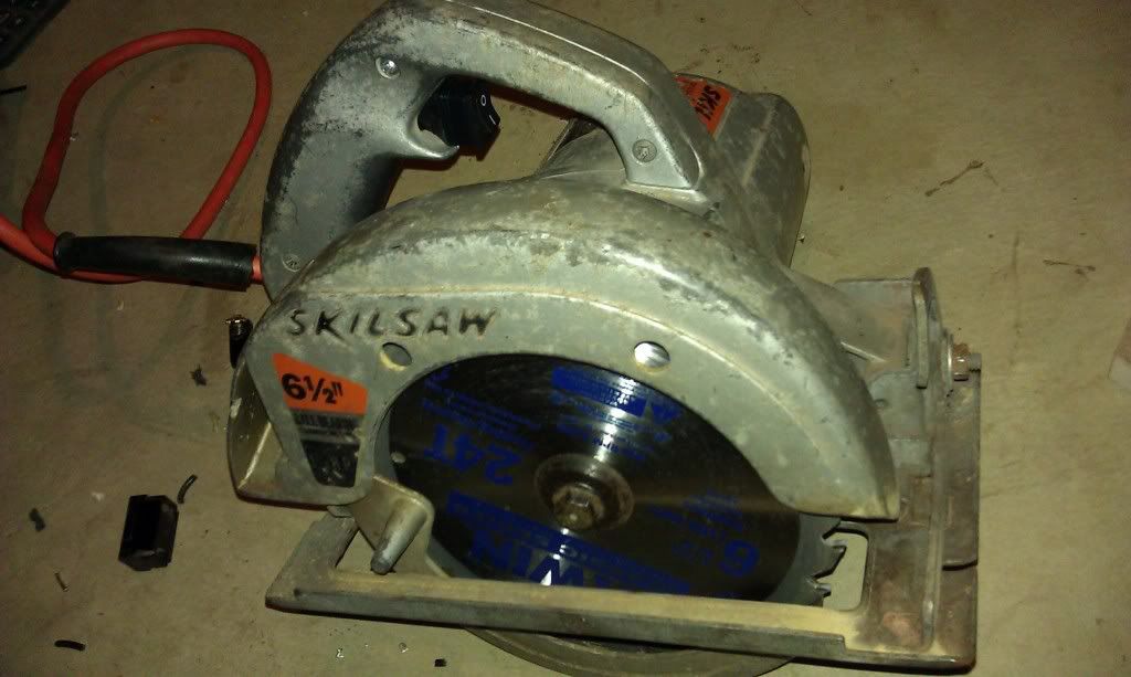

My saw broke I figured out it was the switch that the contacts in it were completely trashed. I tried to repair again (repaired it before) by using solder, but it was beyond that point. So I cracked open a bad computer power supply I had laying around, and pulled the switch out. I soldered the wires up and electrical taped them. Its a cheap fix that works!

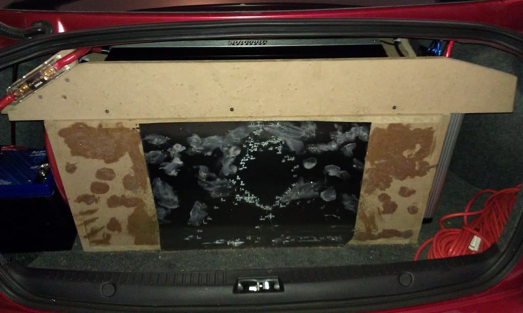

I made a mounting plate for my fuse holder, that way I can easily access it for MECA competitions.
__________________________________________________ __________
Finished product, the cut for the fuse holder went VERY bad as you can see, I will eventually fix that up Im sure.
