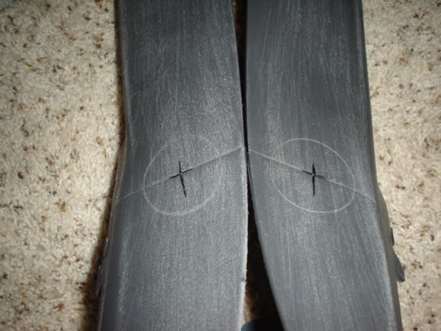

A pillars scuffed and scribed for the tweets

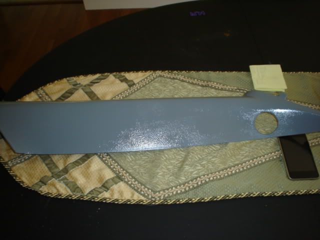

First coat of paint left side
First coat of paint right side

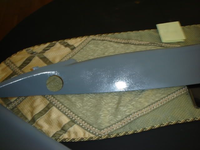

Final coat of paint and tweets installed in A pillar.
Note: I did primer them before the color coat and sanded to 400 grit between each coat. The color is a pretty close match to factory without having it matched, but it looks more like primer in these pix, but its actually the color coat.

What did you use to cut the tweeter holes? They look really even, hole saw?

Yep, I was lucky the hole saw was just a teeny bit smaller than my tweeter cups. What I did was measure across and found the center and took a set of drafting dividers and scribed the the circles a couple times each and then laid the hole saw to them. Then sanded the inside till they fit nice and tight. It turned out pretty good.
