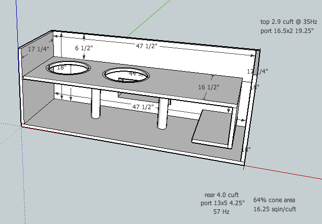

Finally was able to meter the 10's today. Was very impressed with the Flat response from 30-63 Hz.
Here's the box
win ISD plot
6th tuned at 35Hz rear and 57Hz front.

Nice work on the response

Hell ya man looks good
