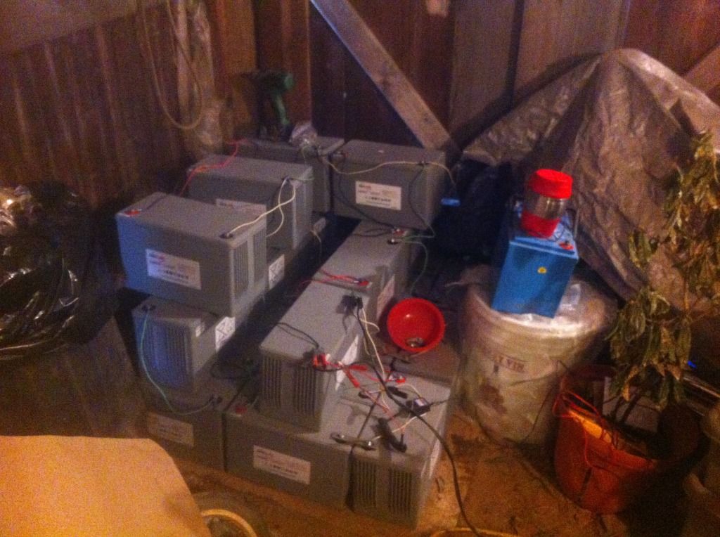

Originally Posted by Todd Dupler View Post
Maintained 36 110ah datasafe batts with a 500ma tender from harbor freight
Nice lol. Do you have them linked with a bar or are u running pos on first battery and neg on last battery?
Just my .02
Old 01-19-2016, 12:23 AM
Todd Dupler's Avatar
Team SPL Farms
0/20 12/20
0/11 sssss5000
Location: Perry County Ohio
Age: 38
Thanks: 446
Thanked 633 Times in 528 Posts
Honestly it was all at random points. Used wire jumpers on all of it.
Shitty pic but you get the idea. Never had any issues. Did the same thing with about 50 c&d 53ah batts. On another note im glad to see you are still around vince. Hadnt seen ya in a bit man!
