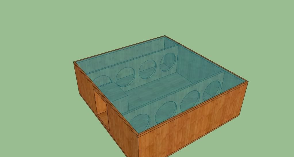

well im decent at sketchup so here something i thought up and should work nicely, keeping it basic for him so its easy to build will still play well, tuned to 46hz

What's the specs?
sealed is 1.83 a side
ported is 7.49 tuned to 46 after disp

Whats the port area and tuning?
A 1:2 ratio isn't too bad, should play pretty low with that tuning.
I believe he stated its tuned to 46hz a page before.
I personally like using 196sqin ports but im not sure if that would work with his design (im a noob when it comes to bandpass)

130+/- 50db would be my guess. Seriously, nobody can predict what any given setup will do in any given car. At least not without tons of experience with the vehicle. Something like a crx or a car that is very widely used for SPL stuff would make life easier, but I don't think many people use Expo's for SPL.
As for your port area idea, that's a huge port for that box. You could easily get away with 120 sq inches.

i have lost the design on my old computer. but there is plenty of port for the size of the ported chamber, should be around 110-140 most likely

how can I figure length for my port? is it calc'd the same way as a ported box? *total noob at bandpass*
http://www.caraudioclassifieds.org/forum/member.php?u=2977
Port length calculations are the same no matter the type of enclosure.
