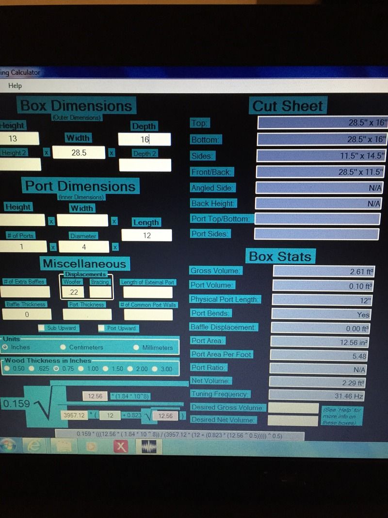

looking at this box design but concerned on the port volume. SA recommends 1 cuft ported per sub for 10'' and I have 2. Trying to keep the tuning low for heavy bass songs, rap and dubstep. These are going into a sedan trunk facing forward and aero forward sealed off from the trunk. Havent bought another amp yet but ready to do so. Prob 750-900 rms per sub at 1ohm. let me know if you see any issues of let me know if it looks wrong.
Thank You Very Much!!!!!

or this one. A lil more internal space
my height max on the box is 13 and width is 28.5'' max. Depth is not an issue

Most will say that you want atleast 12in per foot of port area yours shows less than half of that.Port will need to be bigger and longer or bigger and tuned higher.

In no way being rude but the E series with a 2 inch coil will not last long at all with that kinda power.

Can you please recommend a port size so they can be still tuned to 32-35 hz then. I will then adjust box depth accordingly. 13" tall and 28" is my max width. Depth I can do anything really. And thank you very much for replying.

I think this is the best im gonna get with the port area. Ive been told 9-12 is ok with a flared round port. Tuning is a bit higher then I want but am limited on port size. I can do a 6'' but the length would put the port too far forward to fold up my back seats I can handle 2-3'' but not 6-7. you can see the sketch on the MDF that theres a single 6 up top and 2 4'' on top and below. Tight fit. Looks like im going to be using a few pieces of dowel rod front to back and up and down. Let me know.

Sorry i was thinking a slot type port.I am not the man to ask on round ports but if your right on the 9-12 than your good.Lets us know how it goes buddy.

using aeroports the rule of thumb is 8 to 10 square inches of port per cube....you have 12 so it will drop off quickly below tuning and be a bit peaky just be aware of that

Are you using a 6 and a 4inch aero? The tuning it going to be tricky. They will act like one air mass, not 2 seperate ones. You'll end up needing length of about a 5inch port to make that work, from what I've been told. (never done this myself, but a guy on a home audio forum did)
Anyways a pair of 4inch aeros will be sufficient for a pair of those subs.
