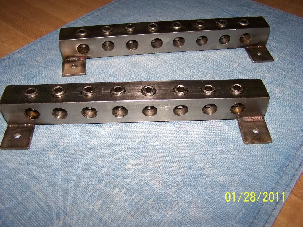

As for buss bars here is what I did.I was running Soundigital last season,and wanted as much battery power close to the amp as possible.Running different kinds of batteries made it impossible to run a typical buss bar.So,I made these up.With this style I could wire in 7 batteries,and have one short lead going to the amp.Never a shortage in voltage,or amperage.

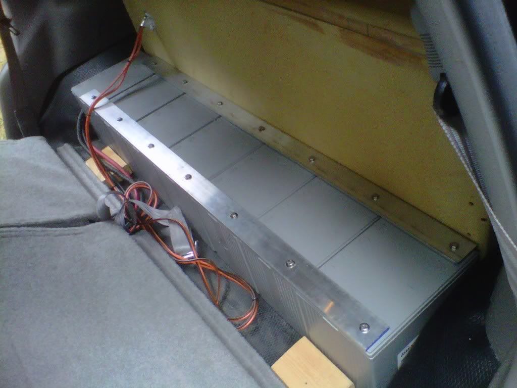

most people around here use 2"x1/4" aluminum but copper is the best, just its so high right now.first pix is of mine second is my sons.this was in the install process.
I like that, looks nice.. That's a heck of alot more economical than the copper.
thanks and it works great
