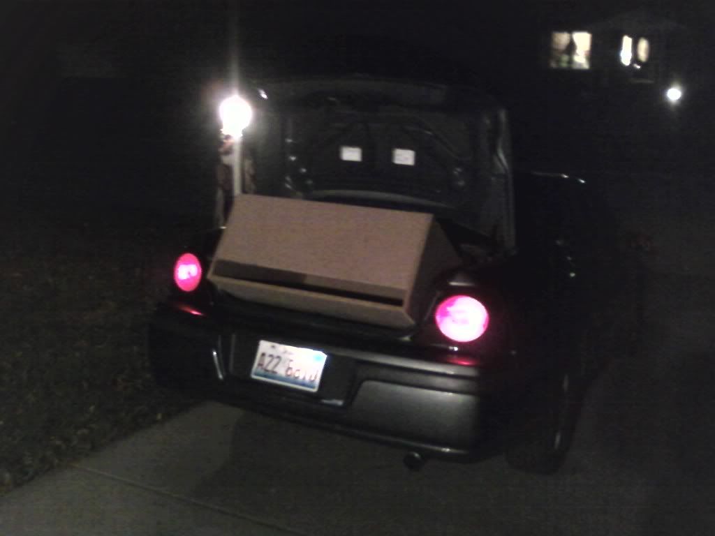

my box wont fit.... lol thats actually dryfitted.
Question is:
In some places i cant staple in some places and its built into my trunk. Can i rely on glue to be strong enough? or what method should i take to seal it? I was thinking glue everywhere. caulk the internal corners and resin over it. good enough? any advice?

babahahahaha!!!!!!!! um this is 6.5cuft..... its an 18.... seats dont fold down but when i removed the backseat to try that idea it still wont fit... lol. its big

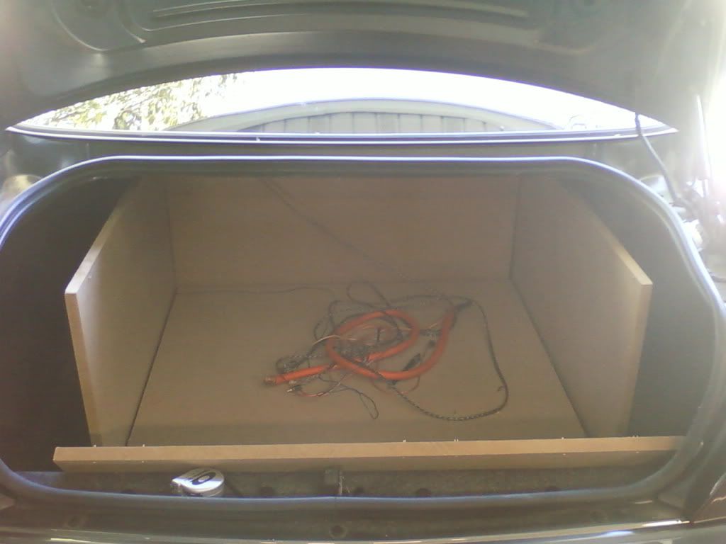

Question is:

Glue is the main thing that holds a box together chemical bond > physical bond. Some people don't even use screws when building boxes. Screws help bring the wood together for a nice tight fit though but so do clamps. Use resin and glue clamp it till dry and you should be fine.
some places i wont even be able to clamp :/
If you need to build it inside the box glue the wood, than use L-brackets to hold the two pieces together while it dries (than remove when glue is dried or leave on)
Screw in what you can as long as the cuts on the sides are decent i am betting you will get a nice flush bond, use a bit of glue/liquidnails or whatever...

i dont want simpler..... im going to use l brackets. its solid. the box design is nice too. i like it. just needed input. no one around here has an 18 in the trunk. gotta mix it up.
