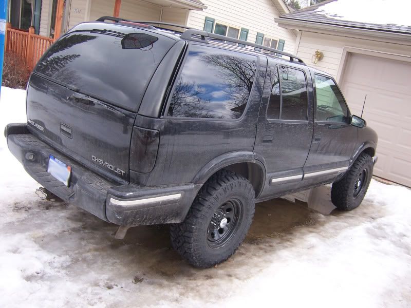

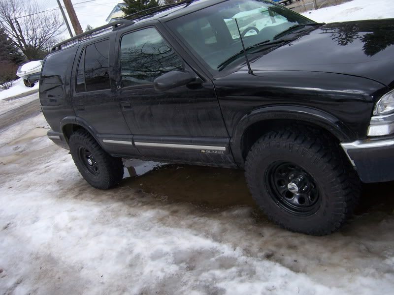

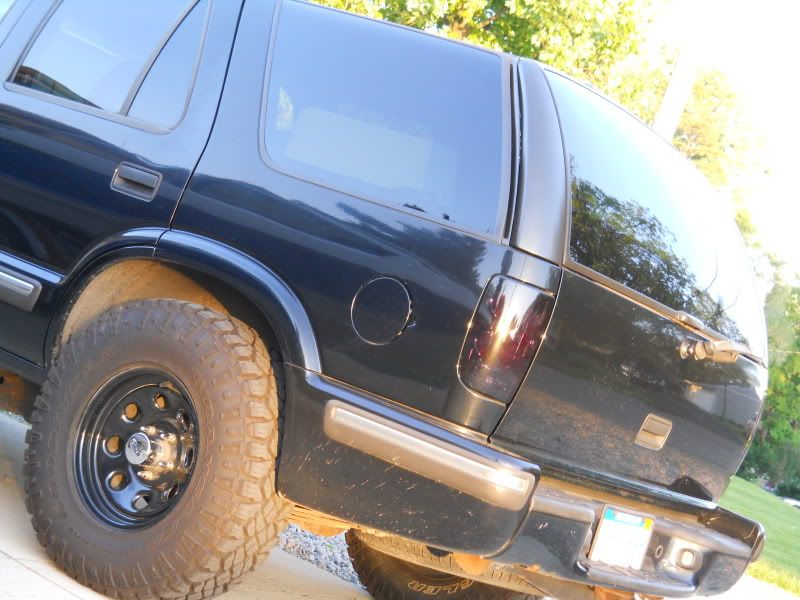

Heres a few recent pictures of the vehicle.
Test fit the wheels and tires, but need to overhaul the front suspension and do some more trimming to be road worthy.
edit- more recent pics...
