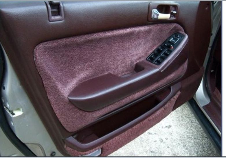

I'm thinking about doing doors for my 92 accord wagon. I'm not positive on what I want to do just yet it's very up in the air. I would like to get some input or ideas from fellow members. All I know is both doors will be powered off of a 1000c4. what would you guys do with this door panel?

Crescendo has there new mids out and they will be coming out with there new tweeters too. I would take a look at them and do a pod on the bottom of the door. That would look pretty sick

Id go for 4 Selenim 8w4Ps per door (with each 4 ran per front channel), then run a pair of Selenium ST200s in each door off the back channels.

I would have said the same thing other than the use of 6's in a row across the bottom of the door.

Nope. You would be at 2ohm stereo on the front with the mids, then each rear channel would be seeing 4ohm stereo.

So your saying 4 Mids per door and Each door wired to 1/4 channel? Wouldn't I be underpowering? Each mid would get like 62 watts

They are pa mids, means they are super efficient so they dont need much power to get loud
Oh nice I didn't know that I thought I'd have to be giving the Rms. And that was a main concern on why I didn't know what I should do. If I did 4 mids and 2 tweets per door where should I put everything?
