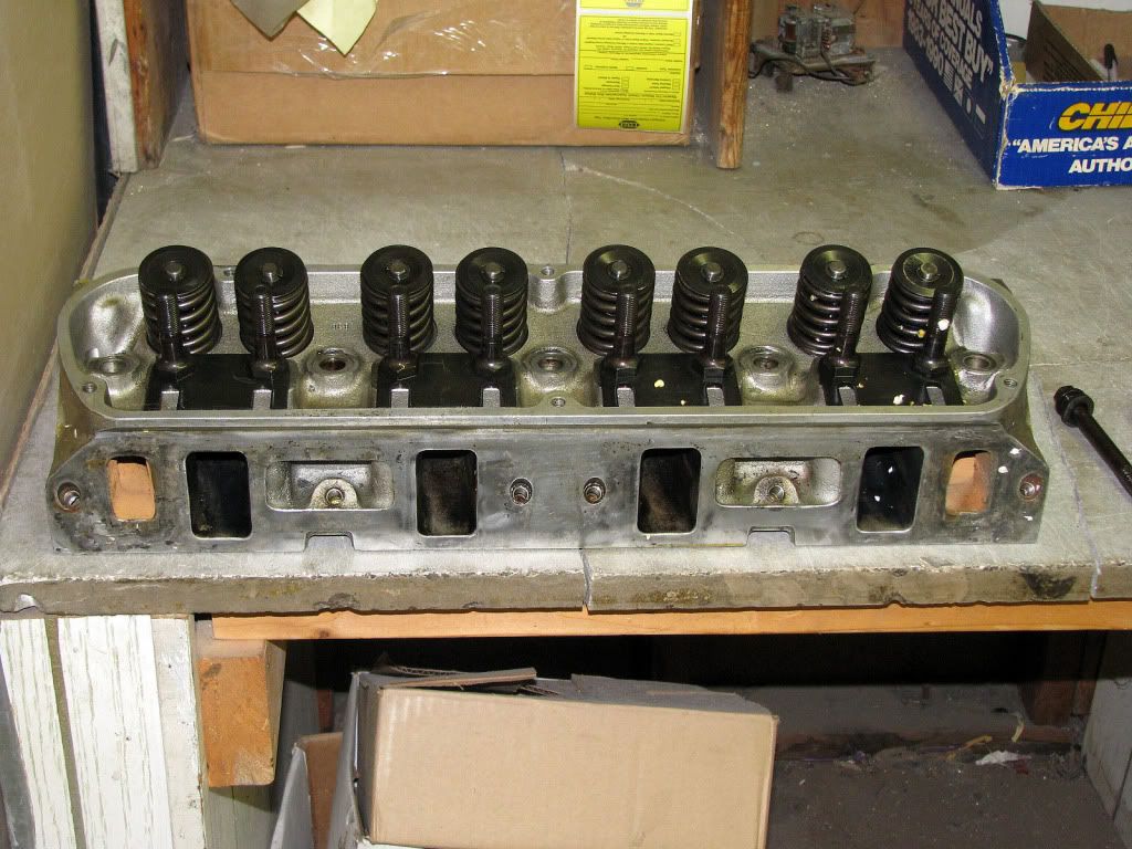

Tore the motor down to find out it has different heads, forged pistons and has been bored .030 over. Still has some of the cross hatching in the cylinder walls.
NEXT - Bought heads, ARP bolts, pushrods and 1:6 roller rockers
$850

Edited first post with pics of the heads/bolts/rockers. :D
