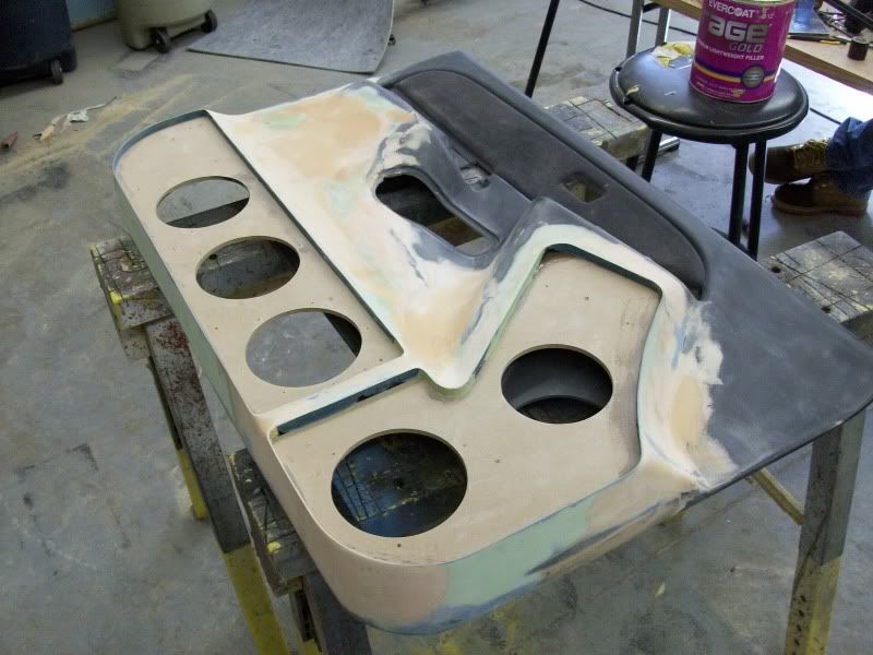

Speakers...... 4 sets of Boston Acoustics SR60s and a mid from a SR50. ( the tweeter will be mounted in the wall with another set of SR50's
the point of no return!

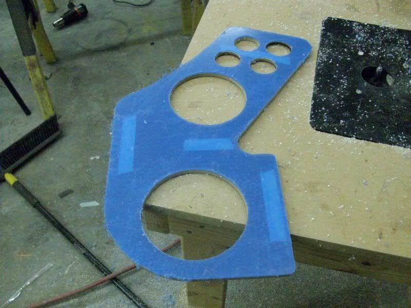

baffles out of 1/4" mdf....
ready for glass
ther will be black plexi inserts over the speakers. i didnt want to have to make rings that wer this complex so i attached 1/2" templates that will be back filled with everglass.

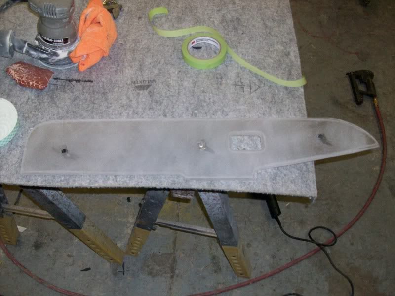

this piece will cover up the stock cloth insert. i used 1/4" lexan that i sanded down. the reason i used somthing clear (and lexan cuz its stronger than plexi) is becasue it will be covered in laser perforated suede. when you backlight that....it looks amazing.
i also superglued bolts in place to attach it to the door
painted the back white so more light will reflect. i masked off areas that LEDS will be
