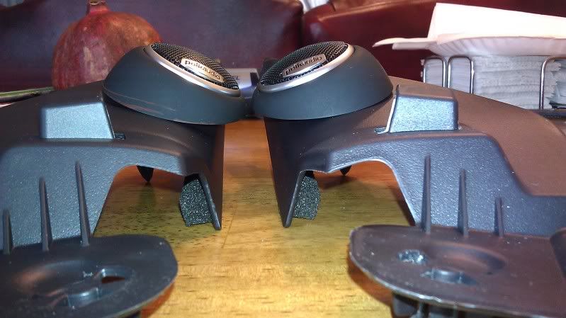

My new tweets are in and without going much into "why" here's basically the only way i can mount them to my interior mirror cover piece
I secured that angled mouting cup with plumber's putty which does the job just great as far as keeping the strenght and filling up holes but i think i will need something on top of that for a more finiched product. Something that will stick to plastic and plumber's putty and will be easy to sand and then paint.
What can i use??

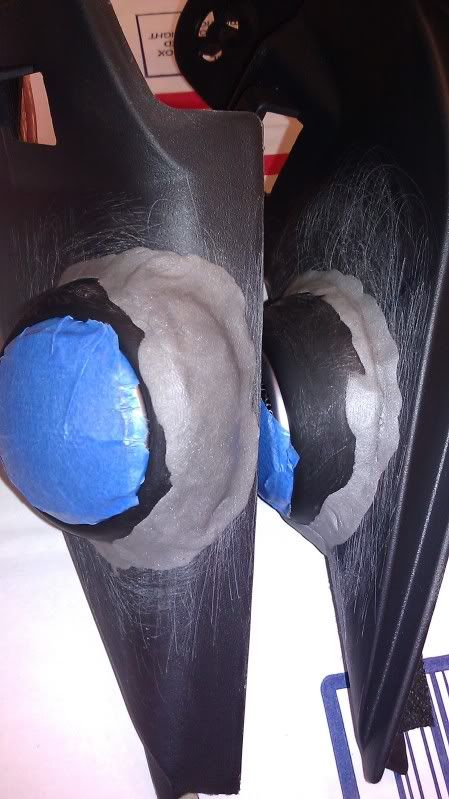

Fond this stuff at auto zone.. worked great. My first try at doing a pillars and I'm extremely happy wit the results
