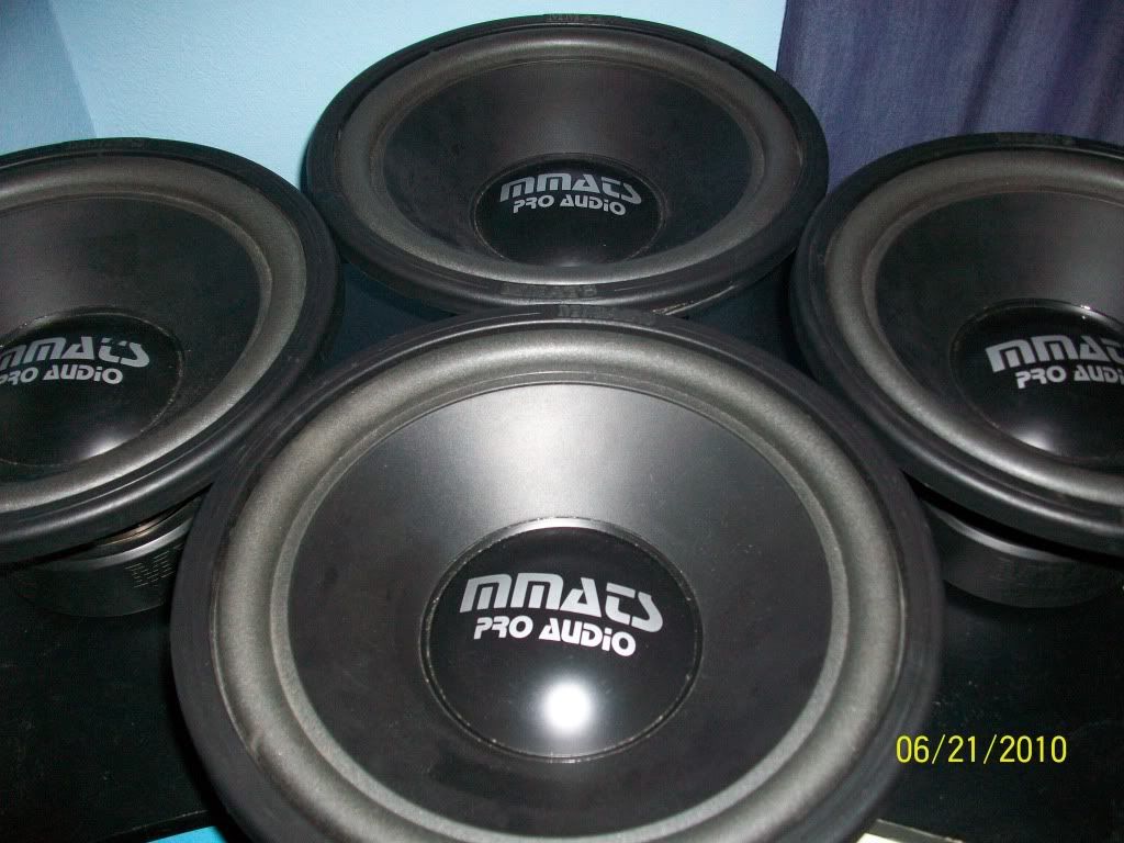

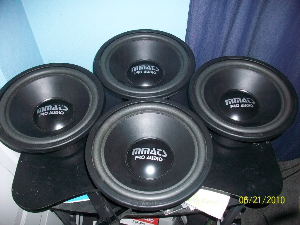

Does anyone know how to remove a dustcap from a sub with out destroying it? (the dustcap)
here is a pic of my subs.

#24 ·
