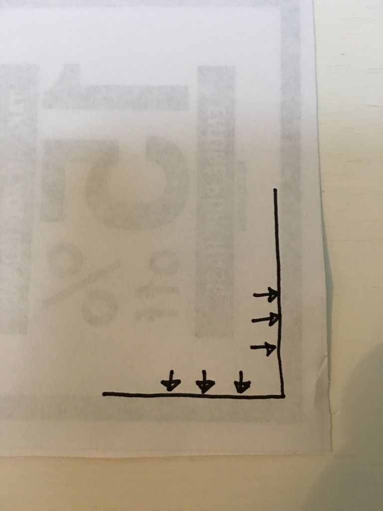

Old thread I just decided to browse through, something I had actually researched heavily in the past. A lot of the comments made here were partially true, just from intuition, but the physics behind it is interesting. Without going into moments and/or moi, I will just point out that pressure, specifically the direction of the force vector in pressure, is defined as being perpendicular to the walls of the (in this case subwoofer) box, which is preventing the force from becoming a sheer force.
But in a 90 degree hard corner, the transition from pressure on one wall to the other is very abrupt. In reality, the corner introduces a pressure gradient, and in the case of hydraulic pressure a sheer force. That's why you never see hydraulic cylinders without rounded corners. Pneumatic pressure is more forgiving, and the tiny gradient creates a small pressure difference. Remember this.
The nearby pressure tries to equlibriate to the corner pressure. It would take more acoustic energy to pressurize the chamber with hard corners than say a cylinder or sphere of the same volume. Why? Sound pressure is oscillating pneumatic pressure; the chamber pressurizes, and relieves pressure into the vent in a ported box, and then reverses the process. For a given speaker "stroke" there is a defined amount of energy that is transmitted into the box volume. This energy is the same energy, that excites the port volume. Given the energy must be conserved, any loss of energy would result in less port excitation. This is where the loss of pressure energy in hard corners comes into play. In an acoustic circuit, it would equate to small resistors, one for each hard corner, especially the tri axis intersections. So he assumption that box rise was lowered is correct, though the volume displacement may have also been a factor in spl results. The size of the 45 is not critical, the more "round" the corner the better. Hard corners in a port will have a turbulent effect as well, but the oscillating air in the port doesn't see the same effects as in the pressure chamber. The argument that air " flow" is better in the box is not true.
